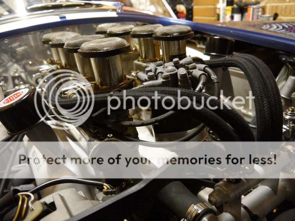

Well, these are competition carbs, they were not fitted to road cars. As such they are designed to be used at high, if not full throttle - who cares how a racing car idles in traffic? Any fuel vapourisation, if any, that might happen with rapid airflow over and around the car will not have any noticeable effect on power delivery. Under serious use, fuel consumption must go up: eight squirters will pass a lot more than four, even allowing for size. And a four-barrel is progressive from primaries to secondaries. With Webers you get the lot at once, as is usually the requirement when racing.
Wonder if I could fit quad Webers to my 2CV van?

If you look at the pic, you will see how the fuel log is attached to the coolant neck. Two thin metal uprights. These cause heat to be transferred to the fuel log, although I am sure under bonnet heat does also have some effect.
I used the 44 IDF's as the larger and original spec 48 IDA's would not fit under the bonnet - not to mention that the 44's are meant to be more tunable and street friendly!

Of course we must not forget that Andy runs a Ford 302? and Nige is running a 3.5 Rover.
Still interested in the outcome of fitting the Dellortos.
