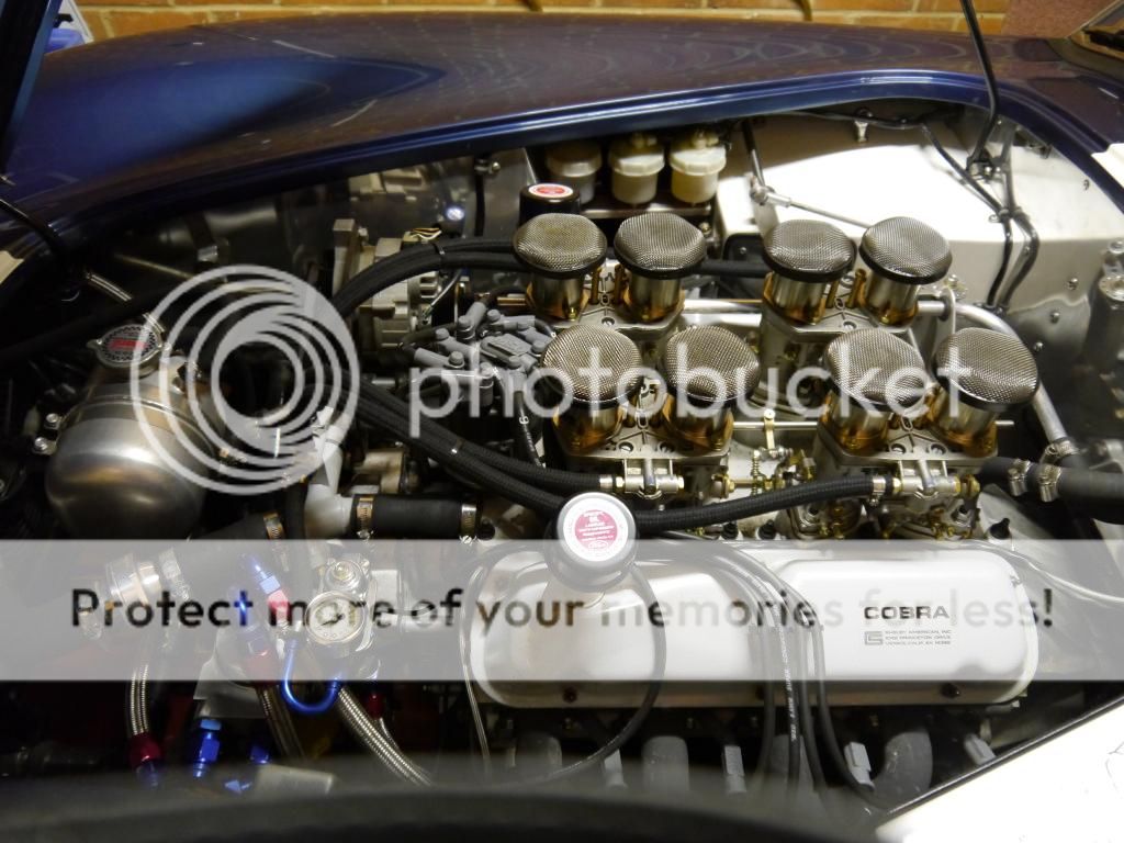

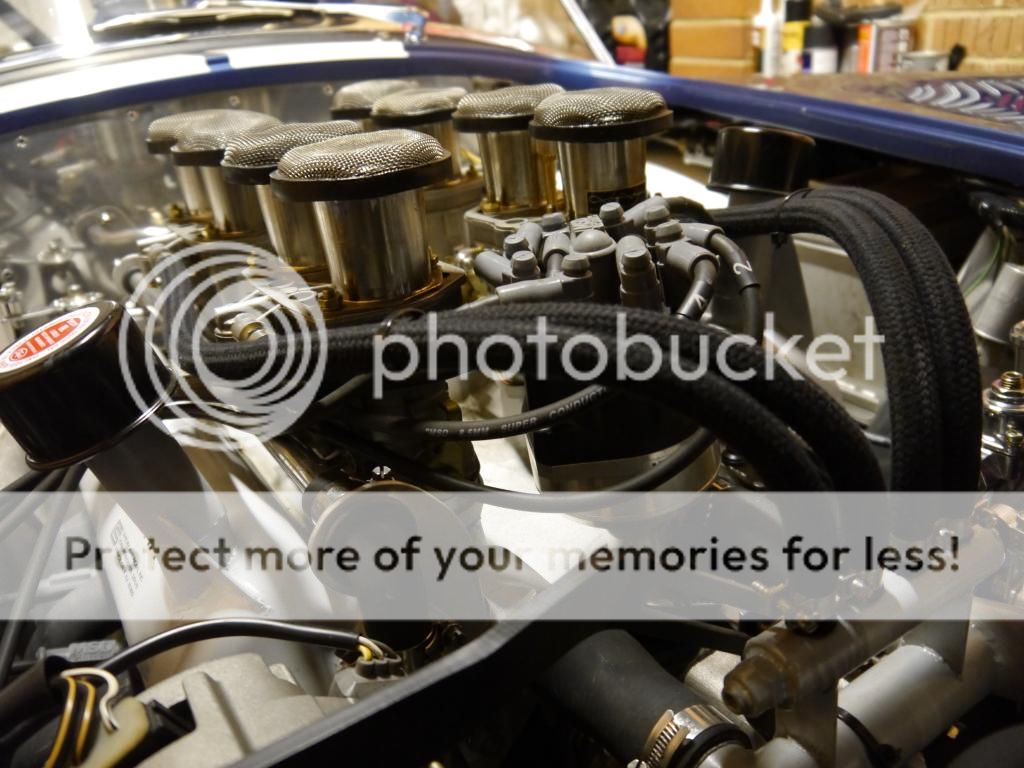

Hi Nige
Myself and Barry run that style intake with 44IDF Webers
I am planning on taking mine off tomorrow so will have a quick measure for you then
Andy

Colin (OCD) also runs that style manifold, but with the IDA Webers.
I'm considering the possibility if putting Webers on mine, for no other reason than they look fantastic. The intake manifold for the Big Block FE tilts the carbs in towards the centre by a few degrees, which adds an extra level of "coolness". 8)

Post by andyg »
Just 'off' Paul
New camshaft going in.
Recommended cam to go with Webers had 216/218 duration at 50 thou. Not much left above 5000rpm so decided to change it for something with bit more duration.
They will be going back on!!
Andy
